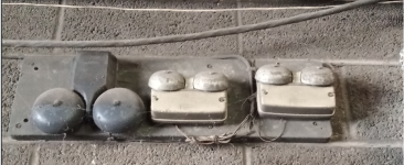

There is something coming down right in the entry that was for the pay phone. That would be a perfect spot for a WAP.
Old timers around here told me this place was really state of the art communications back in the day. A couple of diff business band channels, one for trucks, one for shovel operators, another for supervisors, all being listened to at the same time here.
So I've got to look hard and see what exactly is going where and what is good and believe me I'm still finding more
And lots of ringers. Two other places had them for the shop phones but all that was left when I got here was the wire and the marks on the wall.

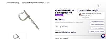

The plan is to follow along the runs the telco used. Anyone see a problem with reusing their hooks? They are nice strong hooks, I'm sure I'm not the only one that remembers them
Those are called drive rings. Remember them? I have boxes of them and used them to run the ethernet cable around my basement a little while ago.

Hardly anybody runs cat 5e now, it’s mostly cat 6 or fiber. If you use cat 6, be sure you get cat 6 jacks and patch panels (if needed). The hooks are also known as “ bridal rings”.
