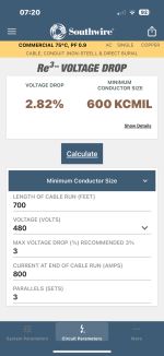

Because if the panel is 200 feet away with a large load then you would need a larger conductor than than the overcurrent protective device rating. Larger wire decreases the voltage drop. So you could have a 60 amp breaker but you may need #2 wire for voltage drop

So if you size an 800 amp feeder for xx feet to limit VD to 2%, and Calc it based on 800 amps, you’re going to have one massive feeder. When in the real world, the chances of that being necessary are infinitesimally small.

Now if you want you can do the VD if you want not mandated by code in this case only recommend.
Use your parelle 500s and the calculated load to see if these work for your VD.
