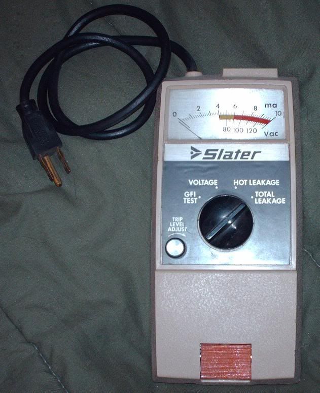

Because there is no other way to make a plug in GFCI tester work. I has to create leakage to ground to test the device and the only way to do that is to use the grounding socket on the receptacle. If there is no EGC, the tester cannot work."Why do these testers look for ground when a GFCI was intended to work/trip to a fault on a two-wire circuit?
don_resqcapt19 said:Because there is no other way to make a plug in GFCI tester work. I has to create leakage to ground to test the device and the only way to do that is to use the grounding socket on the receptacle. If there is no EGC, the tester cannot work.
Don
JohnJ0906 said:If the tester faults from hot to neutral, then you have a short circuit, not a ground fault - the GFCI isn't looking for that. So it has to do a hot to ground. If there is no EGC, then obviously, there won't be a ground fault. Where is this ground path coming from - it's only a hand-held tester.
On a no EGC circuit (2 - wire), use an extention cord from an outlet with an EGC, and use a wiggy tester from the outlet you are testing (hot) to the extention cord (EGC). Now you have a ground path, and the GFCI will trip.

They could make them out of metal, and require the operator to be bare-footed.JohnJ0906 said:Without an EGC, how can the plug-in tester create an imbalance?
JohnJ0906 said:A GFCI is looking for an imbalance between the ungrounded and grounded conductors. It does not require an EGC to do this The built-in test button does not require an EGC to properly test the GFCI. Plug-in testers do require the EGC to test the GFCI. Without an EGC, how can the plug-in tester create an imbalance?
76nemo said:Beee-eye-N-Gee-Ohh, spells bingo. Why not have the ability to test two-wire?
