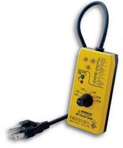

For GFCI's, if I want to see the actual trip level of the breaker or device I use one of these, it lets you gradually increase the leakage.
Roger
Roger
I bought a greenlee GFCI tester years ago. It costs, then, about $80.00. It varies from 0 ma to about 20 ma. It works very well.
Roger
I built something similar with a 12-position selector switch, a Radio Shack project box, and some resistors. I can test from .5 to 100 milliamp.
