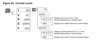

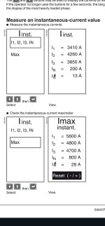

Can you read the real time ground fault current Ig from a display on the breaker feeding the transformer?
It's a Schneider Micrologic 6.0P trip unit. Looking at the manual, it looks like I can show A, B, C, and N, but not the net/residual (or calculated GF) from what I can tell.
From what I see in the manual for the 6.0P, the main screen only shows A, B, C, and N. But if you go to the "metering" menu and select "instantaneous" current, it looks like the calculated residual ground fault current should be displayed (next to the lightning bolt to ground symbol :) ). But the unit in question would have to be checked out to see if it will display the residual current.
Interesting! Which version of the manual are you looking at? The one I grabbed from SE website (rev 7/2020) doesn't show the sample screen for instantaneous. Just that it "Displays current for A, B, C and Neutral (depending on network type)" for the Instantaneous display. Might be something we just have to go to the site to check out.
From here:
Check out pg. 59 of the manual from the link that you provided.
In the figure 24 you showed, the box with [ Ia, Ib. Ic, In ] inside is still a menu selection, and you have to hit enter to get the display that includes the ground current.
Nice! Thanks. I'll see what insight this might show us.
