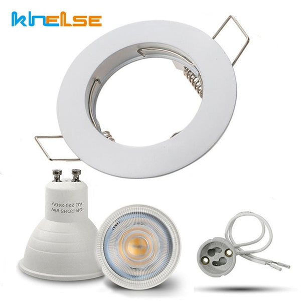

Might look at something made for RVs
Thanks James, I appreciate the help. I actually looked at something identical to this on amazon.
Being that I now know the GU10 lamp fits inside the existing stainless trim ring, I’m going to try and fabricate a clip that will hold it in place. The existing led module has a retainer that screws onto the back of it and that’s what holds it in place. Not sure yet how I could replicate this on the GU10.
I have an extra set of trims to play with because the hood came with 5000k lamps and I ordered 3000k replacements. But now I really want to change to the Hue GU10’s so they’ll sync up with the rest of my kitchen lights.
Im thinking if i can find a GU10 socket with a nipple on it, it would be as simple as cutting some flat metal, drill a hole to slide it over the nipple, and bed the metal down on the side to press against the backside of the hood trim to hold it.
