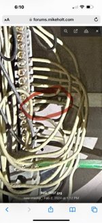

Does anyone have any good reason why this 200 amp service the main breaker did not trip or the service cable caught on fire any good reason or good explanation on why this would happen without tripping the main 200 amp breakerIMG_0057.jpg
Yes, it's Cutler Hammer. We had a load of those breakers failing that were installed in the 80's or 90's. Some don't kill the power when you shut it off. Others the handle will not stay when switched off- it pops back. I don't know why CH has not had a law suit with these breakers. We have replaced over 10 and I bet there are a ton more out there. I know of others who have had the same issue.
If thats a service breaker it is 'up stream' from the cable, those terminals are the supply side of the breaker, unlike feeders and branch circuits. Probably an issue with the oxidation / termination of the aluminum wire.
I agree with Larry it looks like the terminal wasn't torqued properly and the black conductor overheated.
It did not have any DEOX/Noalax on the aluminum terminations to the main breaker
Either to lose or over-tighten
I thought that could be one of the reasons the lug actually melted like butter

I’m in new electrician so all of this feedback means a lot to me. Thank you guys

Noalox is typically not required unless the installations require. But it’s easier just to use it and not get comments. Know what the code and UL requires and win those bar bets
Like Tom stated anti-oxidant paste is not required and won't help with a terminal that is not properly tightened.

Is oxygen not gas that has a deteriorating effect on aluminum?

In true forum spirit we have to nitpick things beyond the actual topic. There is a squeeze type flex connector on the lower black NM and I have looked for awhile and do not see a main bonding jumper, not saying it's not there but I can't find it.

It’s there, just hard to see.

The main bonding jumper is a strap that runs under the main breaker. Almost in line with the switch.
