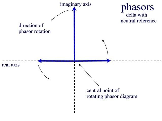

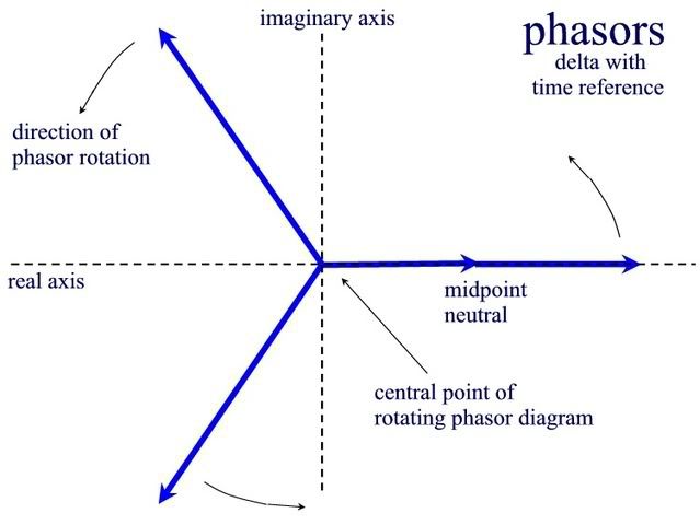

crossman said:Now, say we have a high-leg delta system. Would it be proper to show the voltage phasor from A to C as being split by the Neutral as in the following diagram?
This is not correct. Now that you have the concept of phasors down, let's work on the notation a little bit.
I'll have to look at the labels but as far as the location of the VNC phasor, it would be located directly on top of the VAN phasor. Read my other post and let me know if this is not clear.
[edit: grabbed wrong quote,. I grabbed rattus and I meant to get crossman I incorrectly had the following in here:
rattus said:First off, you are showing a wye diagram. Connect all the arrows head to tail to form an equilateral triangle.
Second, these are static phasors and their magnitude is 120Vrms. It is confusing to provide peak values.
Yes, the head to tail connection of the 120V phasors is correct, but it is not the only correct configuration.
