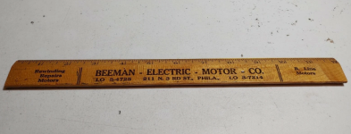

But I had family and friends down around Port Richmond, with two phase services at their properties. That two phase kept lots of the rewind shops in business. There was a guy in Fishtown I think he called the company "Ampere Electric". I think his name was Greg but he was a pretty decent guy. Years ago there was Beeman Electric Motor that was a big shop but that's been gone a long time. I know it was open when his kids were in Boy Scouts with me, but that had to be early 70's
