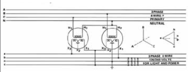

Yes, I assume that's what is probably there. Isn't that why utilities usually provide a 240/120V 3 phase system? And its way out in the country - a mile of the supply looks like this:

But now I realize I wasn't thinking about the whole transformer. Is it the primary or secondary that is usually wired in an open delta? I can't seem to find anything that shows how both are wired. Again, I think the whole point was the utility only provides 2 phases to supply the transformer, but now I'm drawing a blank for exactly how that would work.

If it is only 2 phases and a MGN, going out there, you are stuck with the open delta.
That picture shows a single phase primary. You would need one more hot up top to get 3 phase open delta.

But I'm still not sure how they are getting 3 phase from the 2 wires on the pole, even with an open delta.
It is a pad mounted transformer, not the typically POTS I see on a high leg, and I don't know exactly where the underground run to the transformer goes, so maybe its actually fed from somewhere else.
Well there you go open delta pad mount.
