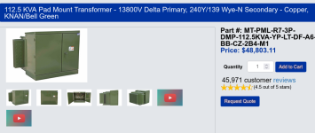

I have no idea, in 2026 I'd be more interested in utilities offering a 240/139 wye, for the 112.5 kVA they look to list for about $4k more than the equivalent 208/120 model.
EDIT: That price difference mainly is because the 240 model seems only available with copper windings, the 208 model is aluminum windings.
