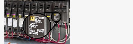

Went back today, spliced in panel 😔 so that I'm not misleading anyone in the future (passed inspection last week), and was surprised at how easy the terminals were to loosen. Previously torqued to 45 in. lb. so it should have put up a tiny bit more resistance, maybe that's saying something(?) but 45 in.lb. shouldn't care if wire is inserted or not.
Below are photos of a brand new HOM 50's terminals. You can kinda see how some 10 stranded might not benefit from full compression as it spreads out - but the terminal on the right is only snugged.
I been using QO seemingly forever and could swear they used to have smaller than 8 AWG at one time for minimum conductor.

I went out to shop and looked at some breakers I have. Had a 40 amp that probably from sometime in 1990's based on some minor details on how logo was applied and/or whether amp rating was molded or printed on it. It says #8 - #2. I can't believe I never noticed this until this thread brought it to my attention.
Now the thing that really makes a lot of sense, I had a 125 amp breaker maybe between 10 and 15 years old and the lug rating is 12 AWG to 2/0 AWG. :unsure:

The only reason I noticed the lug rating myself was the printing. Normally it's raised/embossed text that blends. Later when I examined some 40's / 50's they were embossed too and though all were purchased from same supplier they couldn't find any more printed ones.
I wouldn't have given Homline a second thought, associating it with a box store, but a local quality distributor stocks it and also priced it $60 less than the box store so I bit thinking 'give it a shot'. Well I learned a lot (as well as from your info). I'm sure it will perform fine, 225 rated buss, and I liked the layout & space, but there's a lot of gotcha's.
Result of value engineering. The printing requires an extra step in the manufacturing process.
But the molding requires more part numbers (different breaker sides for each lug size) and more inventory control. Printing requires only 1 blank breaker side, regardless of lug size.
IMO, eliminations of an entire process step is still a net cost savings.
It is a process to manufacture and store blanks with different embossments, it is less of a process to manufacturer a blank side and imprint as necessary. The simplicity of printing is also one reason it is used by counterfeiters.
