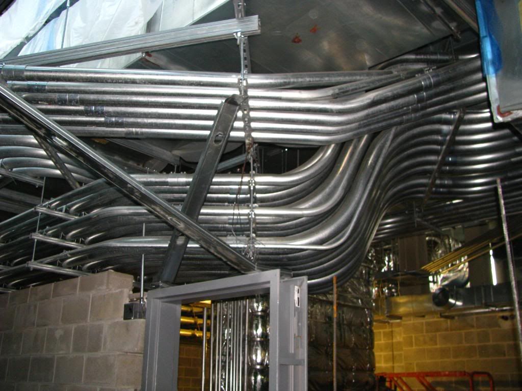

2. The footprint of the building actually has 6 different building types within it and they are all connected in a manner that will be hard for the customer to see when it is finished. The conduit has expansion couplings, and supports that are on some sort of "ball and socket" type of fitting for movement of up to 6 inches in any direction. :cool:
The GC of the building is an ex - electrician, so he gave me the grand tour. I hope to get back there again and get more pics soon. I was there for 4 hours and only got around 350 pics. The lighting kept changing, so some of the pics are not as good as I would like. He will open the vaults for me to look at...I think it is a 200 amp 3 phase service :wink: :D

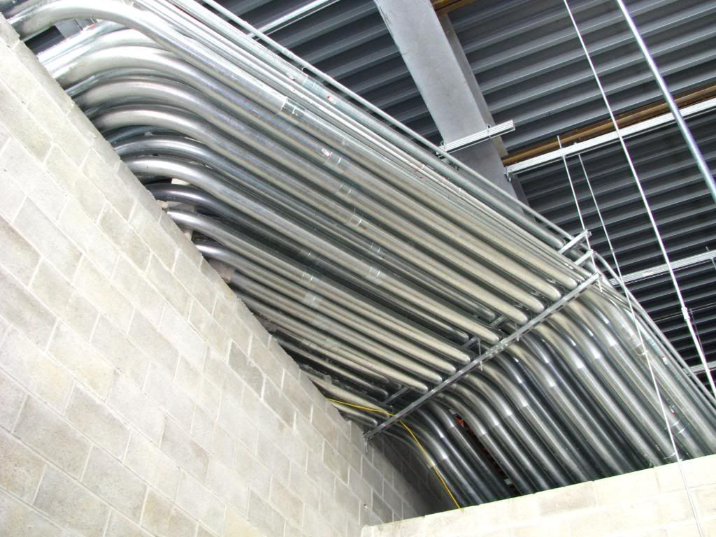

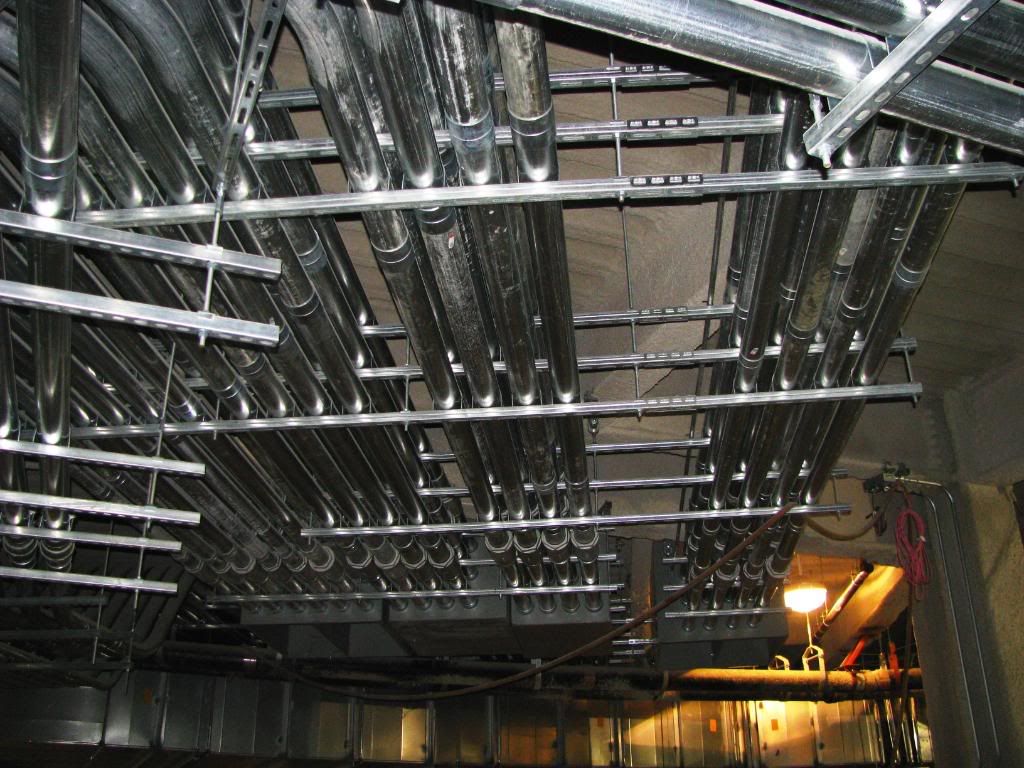

The pipe seems to go on forever
The measurements for the bending are taken in what I believe to be a fairly new system, and is quite unique. The guy taking the measurements is miles away from the jobsite. He has cad drawings that are constantly being updated. He takes the measurements off of the cad and emails it to the job, where it is electronically entered into the bender. You have seen some of the results, here are more.
With this modern take-off, my understanding is they have considerable less waste than most jobs and have saved somewhere in the neighborhood of 10s of thousands of feet in waste.
76nemo said:
Their pipe guys are worth grand dollars, that's nice work.

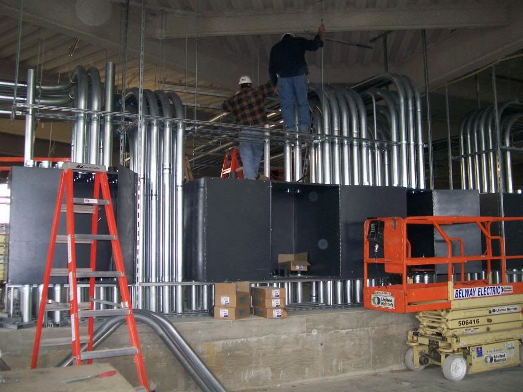

chris kennedy said:
Did you check this pull box sizing?
I was invited as a "spectator". I would not mention one thing wrong if I saw it, as I want to be invited back. :grin:
