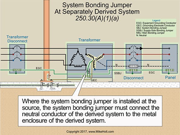

We have this project.
1. Existing 277/480V 3-phase pad mounted utility company transformer.
2. CT Meter, located close to utility transformer.
3. ECB 450A 480V, 2-Pole
5. Panel 1000A, MCB, 120/240V, 1-Phase, 3 Wire
T1: Dry Type Transformer 480V to 120/240V, 1-Phase, 3 Wire
Primary Feeder: 2 Sets (2) #4/0, #2 EG
Secondary Feeder: 3 Sets (3) #400, #3/0 EG
ECB and Panel located beside the transformer T1, at 200 ft from utility transformer.
And this is the ground/bonding connection that the installer made.
I'd appreciate it if anyone could spot any problems with the installation.
If it's correct, why is a second ground electrode necessary on the transformer?
Thank you in advance.
