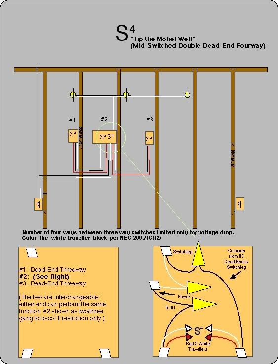

"Placing the feed in one switch and the switch leg in the other switch results in both boxes needing to be a minimum of 16 in?. In my opinion, this leads to less thought during installation and being able to work with one size of box. Less labor, more economy."
Or how about this: Feed into 1st switch, 14/3 to fixture, then back to second switch. Hot goes to common on 1st switch, neutral goes to fixture on white wire of 14/3, black & red are nutted at fixture as travellers. Travellers leave fixture to terminate on second switch, white connects to fixture and to 2nd switch common, bringing the power to the fixture. Less wire, less box fill, less time.
Re: Is my 3-way switch economical ?
Any of the half-dozen or more possible cable layouts that could be used for three-way switches could be the most economical, in any given building.
It would depend on the type of construction, whether there is an attic, basement, or other access for wiring installation.
Most codes require the "switch leg" conductor supplying the fixture to be "other than white." (sketch "C" below)
Ed
That's weird--it's like your B & C drawings were generated by two different minds.
If a person were to prefer Black as common, red and white as travellers for a dead-end threeway (as I do,) why would they suddenly want a red common for the "travellers high" threeway? You've essentially got a dead-end for the switchleg-dictating side. Sounds like a recipe for a mistie, IMO.
Very clear picture, though, Ed. Got any more? :)

But you would be at your limit of 32 cu. in. for box fill in the #2 two-gain and you could not pick up that receptacle down below it with out first running the 14/2 to it first then to the #2 two gain.
:D
:D
Have you been into the egg nog Wayne? I assume you mean "Two Gang" when referring to double boxes. Just for info there are two gang boxes with more than 32 cu in capacity.
I think we're in agreement that that sucker would be a hard sell against box fill! :)
Box#2, 14 AWG garage cali = 11 conductors, 22 inches, plus 8 inches in devices, plus 2 grounding = 32 in, which slides in a 1/2 inch low on a fiberglass Allied box.
