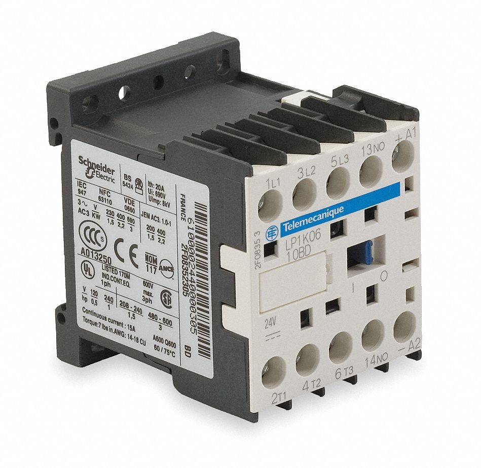

Here is a contactor with guarded terminals, would you install this without an enclosure?
