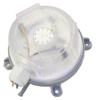

I spoke to my HVAC contractor about this and he told me that it can be installed directly into the AC system return. Since the system has open ductwork the unit does not even need to run when the damper is open.
In my application the AC unit is in the attic so a roof cap would be installed in the roof with a section of duct>damper>filter>return air on unit. A pressure switch at the hood to signal the damper to open.

Hi everyone I need help how to wire makeup air dumper to range hood over 400cfm When hood is ON make up dumper must open. Or I should temper with range hood and install same size wire as power supply to hood and run it to dumper? or use current transformer next to electrical panel that will detect when hood is energized currently transformer will energize dumper I font want to over complicate something what suppose to be simple
my company offers a product that might help. Powered with a door bell transformer typically.
