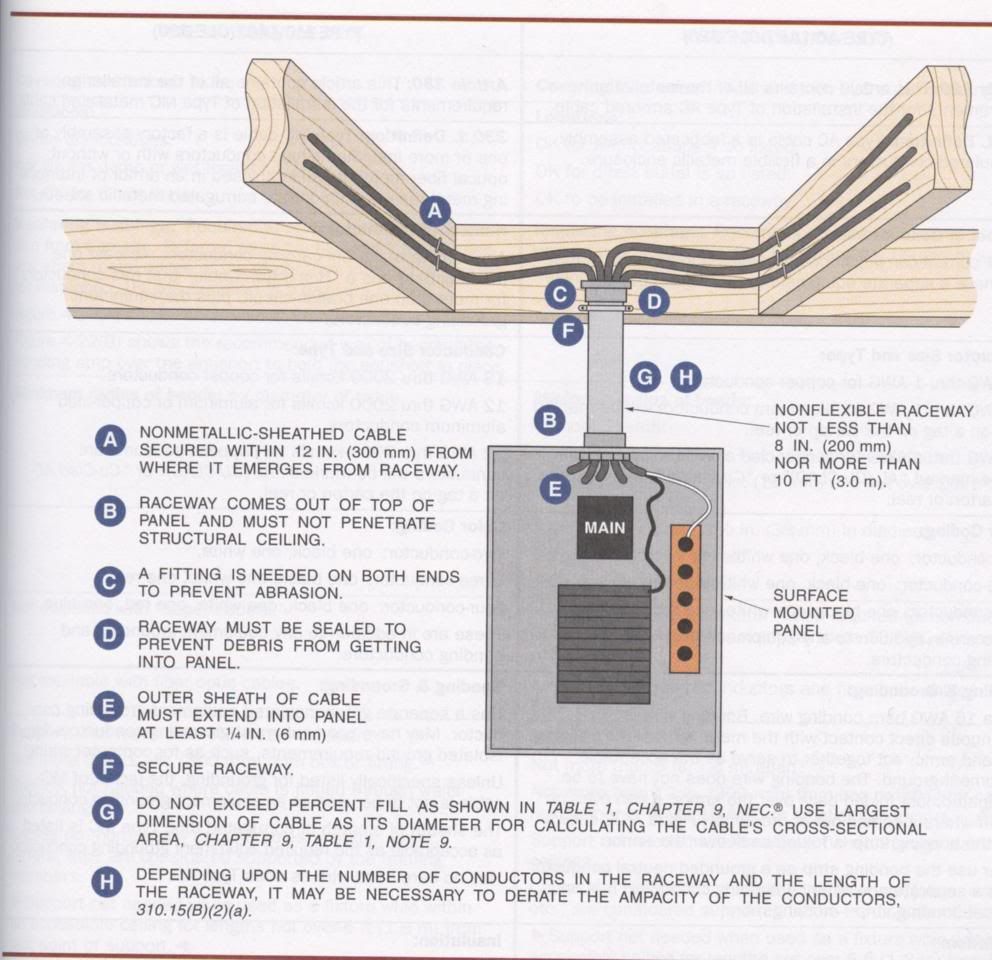

If a panel in surface mounted there is an exception found in 312.5(C) that will allow a chase to be used under restrictions.
In 334.15(C) we are allowed to install NM cable is a conduit to protect the cable.
2005 NEC said:
334.15(C) NM cable used on a wall of an unfinished basement shall be permitted to be installed in a listed conduit or tubing. Conduit or tubing shall utilize a nonmetallic bushing or adapter at the point the cable enters the raceway. Metal conduit and tubings and metal outlet boxes shall be grounded.
In all cases to install the NM cable in the conduit for protection it is required to be a surface mount installation on the inside of the building.

312.5(C) Exception - doesn't this allow the NM not to be secured to the enclosure as one of the expceptions?
(e) The cable sheath is continuous through the raceway and extends into the enclosure beyond the fitting not less than 6 mm (? in.).
Yes. But when we are handed ten provisions in that exception (three are concealed in the opening sentence), all of which must be observed to use the exception, I would call that a "tall" exception to the rule.
I'm also interested in hearing how you secure cables to enclosures, etc.
Personally, I recess panels, and install plastic romex connectors.
If I have to surface mount a panel, then I install a running board and secure the romex within 12" of the panel, and use romex connectors.
And again - does anyone out there have a photo that would help clear my understanding of what the Exception to 312.5(C) is all about.
I don't have a photo, but I can give you a verbal, maybe that might help?
I use a ram-set to mount an indoor panel to the wall of a basement. I now have to run the cables into the panel, but my jurisdiction (say, San Francisco) does not allow romex under 8' to be exposed at all, it must be sleeved in a conduit. This presents me with a problem, because (the main rule of) 312.5(C) says that the cables must be secured to (clamped to) the enclosure.
I'd like to use a 2" or 2.5" EMT right up the wall.
I'm in luck: as long as I adhere carefully to the exception, I can skip securing the cables to the enclosure.

I don't have my Code Handbook with me today, but there is a section in the 1999 Handbook where it discusses the need for junction boxes. In this section the commentary specifically discusses the exception to the need for a JB where transitioning from cable to conduit and uses the example of a romex wired basement with a wall mounted receptacle. The commentary discusses stripping the sheathing from the romex and using a fitting to transition from romex to conduit. For me, this is a common method of wiring unfinished basements. Maybe someone with the Handbook could post this or I will when I get home.
Mark
jwelectric
North Carolina
2005 HANDBOOK
300.15(F) Fitting A fitting identified for the use shall be permitted in lieu of a box or conduit body where conductors are not spliced or terminated within the fitting. The fitting shall be accessible after installation.
Where a cable system makes a transition to a raceway to provide mechanical protection against damage, 300.15(F) permits the use of a fitting instead of a box. For example, where nonmetallic-sheathed cable that runs overhead on floor joists and drops down on a masonry wall to supply a receptacle needs to be protected from physical damage, a short length of raceway is installed to the outlet device box. The cable sheath is removed for the length of the raceway. The cable is then inserted in the raceway and secured by a combination fitting that is fastened to the end of the raceway.
