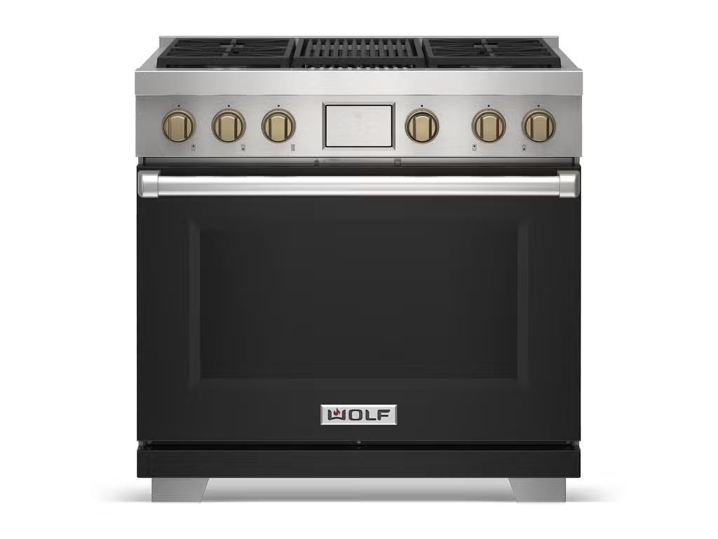

I figured he was referring to dual fuel ranges, where you have an electric convection oven and a gas cooktop all in one range.
In that case we could have the old 3-wire style range receptacle, the N-G bond in the range would be bonding a neutral to a gas pipe.
Now say the service looses a neutral to the building in a storm but the two hots are undamaged, typical if a messenger wire snaps, one could see significant current on that gas pipe.
Fortunately the last dual fuel range I installed was a '240V' model, the neutral was not connected to anything:
So if it was connected to an old SE cable all one would need to do is swap out a NEMA 10-50 to a 6-50 receptacle.
Wich I really think should be the solution for all these.

That is a grounding receptacle 50A 250V, and the 3-wire range receptacle is a dual voltage, non-grounding device 50A 125/250V, 2 different non interchangeable items.

Actually with the range I posted a link to and any other range with a 240 volt nameplate they are, since the namplate of that range is 240 volts, it required no neutral.
So the old SE cable was converted from a bare neutral to a EGC.
