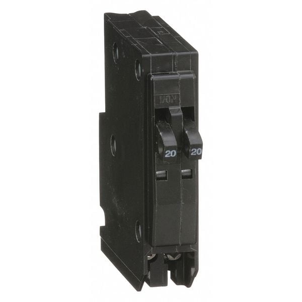

Jim, those look like Square D tandems to me. QO20303020 is a set of (1) 2030 and (1) 3020
The inner handle tie looks like a Square D but not sure about the outer handle tie.
I am talking about the two side by side single pole tandems on the upper left. I don't see any Square D logo or information stenciled on those breakers
Interesting, Why would they make such as the "genuine" QO is, for the most part, readily available. Also how would the use of a "Classified" breaker in the SD panel, even though code allowed, effect the SD long standing policy that the use of any breaker other than "theirs" would void any panel warranty?
Jim,
For some reason, the "newish" QOTs (side x side), have no logo on the front, brand new from the factory.
Makes me wonder if maybe they are a little ashamed of themselves for being copycats...
Jim,
They're probably made by an OEM who is neither of them, but sells it to both. I toured the Westinghouse plant in Beaver PA back in the last century and they were OEM'ing for Square D and Cutler Hammer, which was a separate company back then.
I once seen some QO classified breakers at local lumberyard. This been at least 20 years ago and I don't remember who actually manufactured them. They were more expensive to purchase than genuine QO breakers were at that time.
Was this company making components or finished products.
I been to plant in Lincoln NE that assembled mostly QO breakers back in I believe 1988. I would guess majority of components came from elsewhere and maybe even from places that made components for other names of finished products.
AFAIK Schneider still has this plant but the QO assembly operation has moved to Mexico, not sure what they are doing in Lincoln plant.
