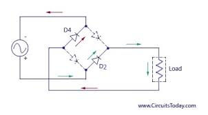

The OP said he measured the solenoid at about 22 ohms. That determines the current from a 480V supply.
Flyback? I assume you mean the current that flows in the inductance after the power is removed. Sometimes called flywheel current.
A full-wave bridge provides a path for that without any additional components.
22ohms of wire ohms, the thing is likely a big inductor, with a 80ms pulse on that coil when the power is cut the coil will create a huge voltage that is seen as a "PIV" on the diodes. as-is there is no path for flywheel current, DC+ bus is on the cathode side of all diodes on both bridges. if you dont squash the flyback voltage (which will peak way above ~676v with fast hard-off pulses) you can bust a hole in diode (possibly short it). and depending on the inductance you may not see 480v/22ohm, depends on henries. i recommend getting a L reading of the coil using LCR meter, from here we can see what the flyback voltage may be. i already mentioned how one can handle the flyback usin zener, or diode(s) across the coil. and if the ATS switch is sensitive to bouncing (bouncing is typically not wanted with solenoid controlled switches) then you might also need to squash the ringing that may be there as mag field collapses, a small tuned RC to gnd will handle ringing. w/o RC i can easily see what freq i need to handle, i then squash it with a proper RC.

There are no pulses. The current commutates from one diode to the next when it gets forward biased. At switch off, the current flywheels through the diodes in the bridge.
Both bridges - what both bridges?

Your drawing did not have a switch in the line from the AC source to the bridge. Put the switch in the circuit in the input side position and draw the load as an inductor and you do have a very large PIV applied to the diodes in the bridge upon opening the switch.
Put the switch on the DC side and there will still be a PIV on the diodes the magnitude of which depends on a number of circuit factors.
If you open the AC side current will continue to flow through the forward biased diodes of the bridge. There will, as Besoeker said, be no reverse voltage anywhere in the circuit above the 1.4V of the double diode drop.
With the switch on the DC side it is, as you stated, more complicated.

true.... my stuff is switched on the DC side of things by fet.
so, what i said earlier --> not true for the setup as shown if the switch is on AC side. my bad.
as-is, when the current stops because of diode dropout you'll see a jump in voltage, but not enough to be PIV worthy.
as-is you could still see ringing due to the LRC ckt that exists.
there has to be a switch somewhere, OP said it would only be on for ~80ms
switch on DC side, then you will have a PIV to worry about on the switch (whatever that is). remember that DC arc'ing across switch contacts can conduct for a long time vs AC that has a zero point.

It is correct that the diodes are a clamp if there is no substantial capacitance associated with the inductor.
Since switching is on the DC side and an FET is used for switching there is something else on the inductive side to clamp the inductive kick.

You put the switch or contactor in the AC supply because it avoids transient overvoltage transients for the rectifier elements. Done it dozens if not hundreds of times on the shunt field of a DC motor.
