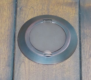

Peninsula receptacle . I have found sillite to have a great product to use in peninsulas. Hook in into one of the other gfci receptacles and these are self contained not ugly easy to install and small footprint for this purpose where we all hate to cut into peoples cabinets.

Finster- I agree the sillites recep. are wonderful and I have used them for years. They are now TR also. They have also come out with a neat little floor recep. that is TR. Sillite.com
