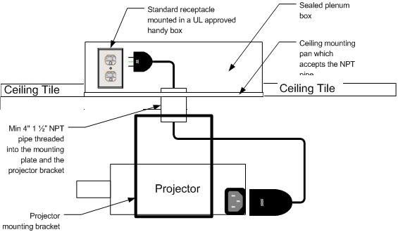

How about a metal enclosure installed up into the ceiling, isolating it's own interior from the plenum, containing a hard wired receptacle for the projector, in a similar manner as a bathroom exhaust fan motor plugs into the receptacle in it's enclosure?
Code compliant or not, this idea makes for a good, long sentence.:smile:
This is EXACTLY the configuration we have here. A fully enclosed box whose interior is isolated from the plenum area. A standard receptacle, UL approved, mounted in a UL approved handy box using either flex or EMT to provide power to the handy box. The projector's power cable is run into the (sealed form the plenum area) plenum box through a 1 1/2" NPT pipe which runs through the ceiling tile and opening into the room above the projector.
If there were to be a fire inside the plenum box it could not possibly get into the plenum space. Possibly some somke could escape around the edges of the box but no more so than boxes that contain power interface for things already approved and installed in plenum areas now.
The power cable from the projector would NEVER enter the plenum space.
As stated by someone else in this thread, Da-Lite should submit this for consideration. Jim

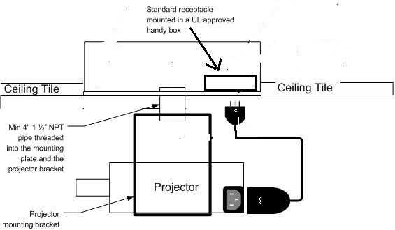

Like this... it doesn't go through the ceiling tile any more

I agree, but it is still above the ceiling.
That would be a violation of 400.8(5).
For the above to be compliant someone has to put in a code proposal for a change.

Yes the way we do it now
iwire said:
That works and many projector mounts come with a spot to do just that. :cool:
Yes, the very box assembly we are speaking of from Da-Lite has the knockout in the face pan part of the bracket. We have been installing them this way since we started installing projectors in dropped ceilings. But this does not address the very issue I am getting at here. How is this any more safe than running the cord 10" inside a sealed plenum bux, either from flame spread or smoke density in the plenum space?

If the inspector sees a power cord going up through a hole into the 'ceiling' it is likely going to be a problem.
Change the code or change the problem but as it is presented here IMO it is a very clear violation.

I think the inspector would be incorrect to cite the power cord as being in voilation if the surface of the box that separates it's interior from the space above the suspended ceiling surface is visible.
How about if the whole riggins, box and all, was below the suspended ceiling? Would it be a violation then? Looks to me like a great big "in use" receptacle cover.
They just want to make a nice looking job and have even taken the plenum thing into consideration. I think if the entire box is above the ceiling, then yes, it probably wouldn't fly, but if its lid was exposed, and it didn't pass, then there'd be hairs split alright, but it ain't me doin it:smile:

Having the receptacle cut into the tile facing down or into the mount facing down has been suggested a few times.
The OP does not want it to show, IMO they have no choice.

What separates those for the suggested installation of your projector mount is the plenum, and and accessibility without disassembling the mount. If you say had an enclosure adjacent with a grommeted hole for the cords, an outlet inside it and sealed from the plenum, but more importantly accessible from below the cieling - IMO that would be OK as it would be much like a floor access box, but in the cieling.... Something like below... I'm sure there'll be some discussion about it....
stickboy1375 said:
I'm confused also, what on earth is so hard about having the receptacle installed next to the projector?
The reasoning was presented earlier in the thread but a synopsis here is that we want to hide the receptacle to make a cleaner more attractive installation. We can make almost everything disappear if we can figure out a way to get the A/C connection in the plenum box. for more detail see my inital couple of posts. Jim
