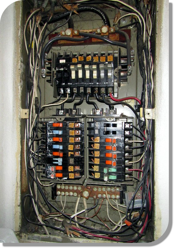

Show me a new split bus load center that accommodates that.
What?

Also, I know you might say 'no North American manufacture could fit more then one submain in a panel without going to a DIN rail" and with that I say not true. Dual split buss panels were common at one point in time :D
http://www.nachi.org/forum/attachments/f19/47132d1312566462-unknown-object-panel-dscn5736.jpg
https://lh3.googleusercontent.com/A...8zvP-q0oG0F-Zjf28fQrP69pZ40XCQuhS2sGHL4P3Qx0k
https://lh5.googleusercontent.com/c...mdVPNVVrysP8XdBSARMLGhIehVVgtFI9-BodCh4VJDhKA
http://www.nachi.org/forum/attachments/f19/24840d1224962175-need-help-understanding-panel-086.jpg
http://inspectapedia.com/electric/Cutler_Hammer_Panel_2118_BobSissons.jpg
I am saying that even if the cumulative leakage current was 0mA that one random faulty appliance will trip it all and that makes troubleshooting difficult and costly to the homeowner.
True, but that should not stop manufactuers from offering that option. I know others have metioned on ET (shockdoc for one) that if they offered a submain system they would use it.
