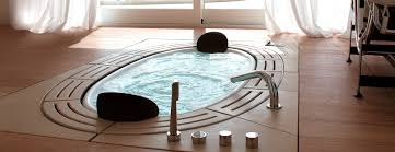

Okay so let's assume this tub shown which is sunken into the floor, is 5' from the wall. I say that because there looks like there are chairs there. More like a hot tub or hydromassage tub but pretend it is just a tub. Can I not put any outlets in this room? Where is the tub rim?
I was going to suggest a similar situation. Can't say I have ever seen it but is certainly possible.

Sorry I forgot to insert the image. I inserted it above but I will do it here also. We all know this may be unusual but I am just trying to make a point. The code states over the bathtub not the decking. The tub is the tub and nothing more. I think we can all agree that this section needs work.
