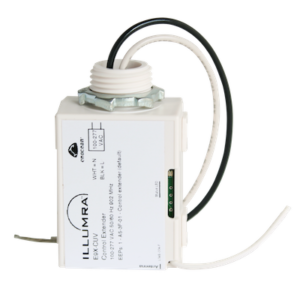

One way that would certainly be compliant, if not the least cost, is having a wireless transmitter and receiver bridge the two SDS.
For example, with the following transmitter and receiver/area controller:
