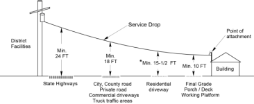

I received a notice today about the overhead being too low in the backyard of a resident's property. I always thought that the requirement is at least 10 ft. high minimum. The notice from the power company wants it to be 12 feet high. There's no driveway in the yard, just grass. I've never been required to take it this high.

The point of attachment is 12 ft high. I agree with you on being their problem, thanks. I just thought that the minimum clearance is 10 anyway.
If the point of attachment is 12 ft that means that the low point of the sag is going to be less. You are responsible for installing the point of attachment, no? Probably what they are complaining about.

Isn't the NEC ground clearance for all residential properties 12'? If the POCO has the same requirement I can see why there is a problem.
230.34(B) lists the NEC clearances for service drops.
Its 10' minimum at lowest part of drip loop and over pedestrian only areas with the voltage to ground being 150V or less.
Its 12' minimum for residential property and driveways, and commercial areas not subject to truck traffic and the max voltage to ground can be 300V. This gets bumped to 15' if the voltage to ground is above 300V.
Its 15' minimum over streets, alleys, roads, parking areas with trucks, driveways other than residential, and open raw land.
So POCO could be confused about the details of the property unless there is a back fence with a gate wide enough to allow vehicles in the back yard which would bump the requirement to 12'. It may be hard for them to remember all the permutations and rules and just put 12' in their brain.
Sounds like all residential buildings are 12' minimum.
That is for up to 300 volts to ground. Dwelling services are typically less that 150 volts to ground.

    3.0 m (10 ft) — at the electrical service entrance to buildings, also at the lowest point of the drip loop of the building electrical entrance, and above areas or sidewalks accessible only to pedestrians, measured from final grade or other accessible surface only for overhead service conductors supported on and cabled together with a grounded bare messenger where the voltage does not exceed 150 volts to ground
  • (2)
    3.7 m (12 ft) — over residential property and driveways, and those commercial areas not subject to truck traffic where the voltage does not exceed 300 volts to ground ...
  • However the code is not very well written in this rule.
I agree. 12' "over residential property" with a 120/240 volt service would still be under 300 volts to ground so if it's over a residential property the minimum is 12'.
I would use the 10' because that circuit is under 150 volts to ground.
Look at the punctuation.
(2)3.7 m (12 ft) — over residential property and driveways, (comma)
To me that isolates as 2 separate conditions, 1: residential properties and driveways, and 2: commercial areas without truck traffic not exceeding 300V.

I agree but that's not what that section says. (2) is very specifically saying it applies when it is over residential property.
But (1) applies to all locations and occupancies, other than the occupancies specified in the following list items, with a voltage of less than 150 volts to ground, The less than 150 volts to ground in (1), trumps the term residential in (2).
