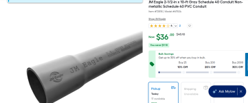

The conduit is cheap and easy though. This in 1 1/2. That is room for a bunch of residential circuits. And if you want to add a circuit it's big enough to just push a piece of NM through. How large is this circuit?
