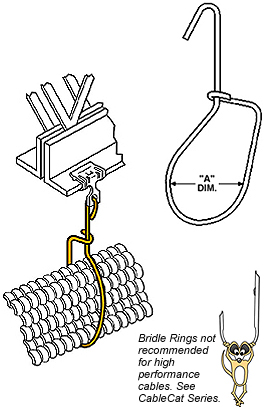

This is what we have been using for multiple runs of mc

I am running MC fixture to fixture in a drop ceiling with a concrete deck. I dont want to tapcon the mc with one holes to the concrete deck but I cant think of any other way to support the MC. The ceiling isnt up yet so I figured i get ahead of them. I thought about when shooting my fixture supports in the deck for the fixture tie ups maybe shooting extra to tie the MC to. Figured Id ask for some other ideas.
Use a hilti gx 100 or gx 120 Gas operated track fastener is extremely fast as fast as you can pull the trigger it fires. We also used to use the ceiling pole powder actuated tools with a washer and tiewire long enough to strap about 10 cables every 6 ft for mc cable.
Flex
poestenkill ny
Ive never seen that style of bridle ring before either. I think for just this single mc I am gonna go witht he tapcons though. Light tails are the only thing allowed in MC. All other power must be in conduit so no need the set up for future MC's.
