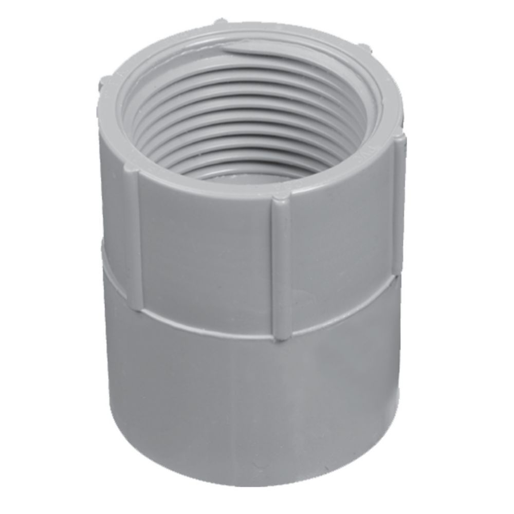

Pardon my ignorance, is the connector pictured below what is being referred to? If so, I assume from the description that the setscrew side is inside the cabinet, with the male threads sticking out. So then wouldn't you put locknut on, securing it and grounding it? The PVC female adapter can then go onto the remaining threads.
Cheers, Wayne

The connector is similar to what you are showing but there is a piece of pvc coming out of the panel with a fitting that is a pvc coupling on one end and has threads on the other end -- the connector screws into the threads
Thanks, that clarifies it.
It also means I retract my comments about the setup being compliant with 312.5, as the stripped end of the SE isn't secured to the meter pan.
Suppose instead a squeeze connector is used at the bottom of the meter pan, with the male threads on the outside of the meter pan. The male threads get a locknut and then a PVC female adapter, then a short PVC sleeve including an LB. That should satisfy 312.5 at the meter pan.
Would there be any need to secure the SE cable where it emerges from the far end of the sleeve? If not, that would eliminate the isolated metal connector that needs bonding.
Cheers, Wayne
