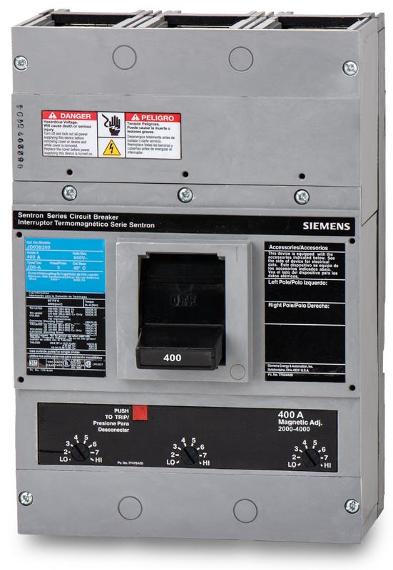

We are building a new Electrical service on an existing building. The existing building was single phase, and they are moving to three phase 208. We are refeeding all the existing single phase panels and are adding a separate three phase panel for a few three phase loads they are adding. This is a total of four panels, three existing single phase and one new three phase panel. The building is becoming a small brewery and they have need of a few three phase circuits for brewery equipment.
The service is a 3-phase 400-amp overhead service, and the service disconnect we are installing is a DG325NRK (pictured below).
The disconnect pictured above needs to feed four separate disconnects and the lugs included are only rated for a max of 2x 300KCMIL wires max. I need to run four 250's out of this. There is not a lot of space on the load side for bigger lugs, so my solution is to use a 2-Sided Insulated Multi-Tap Connector (IPLD250-4 or similar).
What I am thinking of doing is running two wires from the included load side lugs, passing these two wires directly through the multi-tap connector above and taking those wires directly to two of the panels, then using the two open ports of the insulated lugs as a tap to feed the other two panel disconnects.

Personally I would install a wireway or a pull box below the disconnect and install the taps there. How long will the tap condcutors be?
The panel disconnects are all directly adjacent to the service disconnect. The farthest one, as far as wire length is concerned, would probably be 15 feet or less.
So you're good with the 25' tap rule. I wouldn't attempt to cram 4 of those connectors in that small gutter space within the 400 amp switch. Those lugs cannot be changed to accommodate 4 conductors?
Standard four port lugs are too wide to fit here, I just had the thought of trying some stack panelboard lugs, likely the only thing that fits inside this housing. something like a PB4600 might work

I am confused. You are installing a new service and trying to use a piece of equipment that seems to be inadequate. Why do you not just install a new service to meet your customer's needs??
Four 250's (assuming per phase) is going to be fun task just to get into the enclosure let alone terminate them in there.
As mentioned use a splice box or wireway and make taps in there. Connector like you had will work but needs to be six ports. Bring parallel conductors from the main disconnect to the two center ports and place outgoing taps in the out side ports.
I was thinking the exact same thing.
Either that, or I'd be seriously considering using the disconnect to feed a 3r MLO MDP with some feeder breakers.

.....Or........ If you went that route, I might just get rid of that fused safety switch and put a 400A. MB with distribution breakers to feed the 4 panels. Lots of ways to do it.
