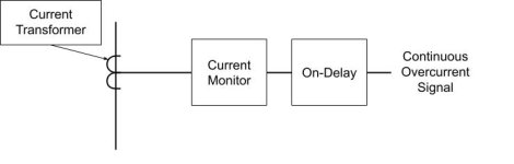

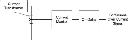

While I am waiting for thoughts from others, let me share my idea. I am not an expert in this area so my idea may or may not be a suitable idea and I'd appreciate constructive feedback.
The overcurrent monitors I've seen do not seem sufficient. They can trip if the current is above a set level but the ones I've seen only have a few seconds on-delay for motor starting. My understanding is the 80% overcurrent limit is for loads that run longer than 3 hours. If anyone knows of an overcurrent monitor that has a long on-delay please let me know.
Otherwise, here is my idea to detect continuous overcurrent (which is below the breaker limit):
  • Use an over current monitor to detect current above the 80% level.
  • Use an on-delay relay timer to register that the over current has been happening continuously for a while.
The 3 current transformers step down the 3-phase current to a range suitable to the current monitor.
The current monitor (eg, a Time Mark 2742-24) is set to trip when any of the 3-phase currents is above the 80% continuous current level. However, this trips if the current is over the 80% limit for more than 20 seconds. What is needed is to detect an over 80% for a longer length of time. For this I propose that the signal from the overcurrent monitor be passed to an on-delay relay timer.
When the signal to the on-delay relay (eg, a THL-8024U-42) is on, the on-delay relay starts a timer. Any time the signal drops the timer resets. Only if the signal is continuously on for the on-delay time does the output of the on-delay trigger. This only would detect over 80% and not detect how much over the 80% the current is.
I'm not sure what the on-delay time should be. I guess it could be 3 hours but because the amount over 80% is not measured, I'm wondering if the time should be shorter. Maybe an hour? Or 1/2 an hour?
This only detects the continuous overcurrent and does not address what should happen in response. Right now I will leave that discussion for later.
I welcome constructive feedback.

Do you have a long term way to measure the building service feed's continuous current separately from the peak current?
yes, with some buts.
our local jurisdiction tag locks the compartment with the conductors.
we are working on getting a formal rule change to allow access to place ct clamps in what's called the green book.
Thank you. That is very interesting information.
Anyone have any thoughts on this? ie:
  • Would this design work?
  • Any improvements?
  • Would tripping at 1 hour be a reasonable or good choice?
  • Are there different designs?
