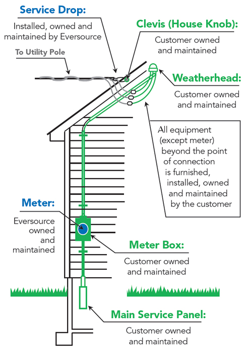

I searched the archives and don't find any discussions over this matter. I've worked some places where the Utility provides and mounts the means and recently because of that got cited in another jurisdiction for not providing one. Can anyone provide me where to find, black and white, where it states for the EC to provide the means for the Service Lateral to structure connection means?
This POCO serves several counties and have in past (in other counties) supplied and installed the hook.

What does your utility reg, say?
5.0 PERMANENT SERVICE – OVERHEAD
5.1 General
The customer, architect, or contractor shall contact the Company prior to the start of construction
to ascertain the point of attachment for the service drop, type of metering facilities, costs, and other
information relative to the customer’s service installation.
Where overhead distribution facilities
are available, the Company will install a suitable overhead service drop to a point of attachment
on the customer’s premises as designated by the Company.
The point of attachment will be
located to provide the least cost and shortest practicable service drop distance to the Company’s
facilities.
The point of service is the connection of the overhead service drop to the customer’s
service entrance conductors/equipment. The Company shall provide, own, install, and maintain
the service drop conductors from the overhead distribution system to the point of service.
The customer shall provide and maintain a safe, substantial support for the Company’s overhead
service conductors. The service drop support shall be installed in such a manner to maintain the
clearances specified in Section 5.2 and Exhibit 2.
The customer shall furnish, install, and maintain
the service bracket necessary for the attachment of the Company’s service drop conductors (refer
to Exhibit 7). In cases where a service mast is required, only power service-drop conductors shall
be attached to the service mast.
When NEC added definition "service point" it was supposed to help clear up some confusion on what is covered by POCO and what is covered by NEC.
First thing to ask here is where is the service point in relation to the POA? If it is at the POA you may still have some confusion but if clearly on one side or the other - you should have a clear answer.
