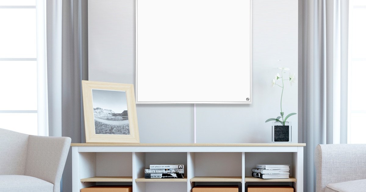

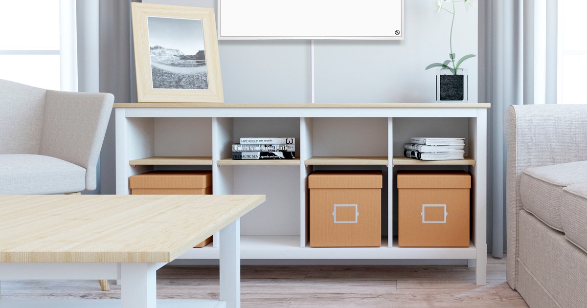

Another option that is very good heat and not expensive to operate is radiant heat panel. No hot/cold spots, and can be wall or ceiling mount. They now offer one that has mirror surface that might be ideal for bathroom.
