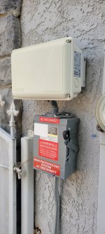

Thank you for your valuable input, much appreciated.I installed a few of those Solaredge/LG systems. The battery backup output is only about 25 amps.
In the picture we're missing either the grid connection or the backup loads connection. I'm going to guess that the small Square-D panel to the left of the inverter is actually the backup panel (mislabeled) and other connections go through the wall. I suppose it's also possible that panel contains the connection to the grid and there are actually no backed up loads.
Either way, this system is very unsuitable for integrating with a generator because it cannot handle whole home backup because the pass-through amps are so small. You're going to have to leave it on the supply-side of the ATS and backup different loads with the generator, I think.
This looks like a DC combiner to me.
Dude, no it's not. Kitchen lights, refrigerator, kitchen, master bedroom. And that's a common Homeline panel, not listed for DC.This looks like a DC combiner to me.
I see panels that look like that used for DC combiners all the time, but whatever, "dude".Dude, no it's not. Kitchen lights, refrigerator, kitchen, master bedroom. And that's a common Homeline panel, not listed for DC.
I see panels that look like that used for DC combiners all the time, but whatever, "dude".![]()
You understand that the "dude" business was just a joke between me and jaggedben, right?Now now dude, that’s a 100a homeline 3R 6/12 sub panel.
I think what you might be thinking of is a DC combiner like an Outback FWPV6, although it’s fused.
The only solar ATS ESS that works well with a generator is Enphase’s system controller 2, or you’d need to go to a Solark or Outback Radian. The latter two, while effective, aren’t exactly consumer friendly and easy to use.
Any Ideas on this concept ..Either way, this system is very unsuitable for integrating with a generator because it cannot handle whole home backup because the pass-through amps are so small. You're going to have to leave it on the supply-side of the ATS and backup different loads with the generator, I think.
Why is the meter main labeled 'Backup Panel'?
Maybe running the utility feed to the solar inverter through the manual transfer switch instead, My intention of using the manual transfer switch is to only have 1 the solar or 2 the generated feeding the distribution panel at any given time. the normal position of the manual transfer switch would be intended to allow the solar back to the distribution panel when utilities is present although it will take a manual engagement.How is the utility side feed to the solar inverter isolated from the loads backed up by generator?
