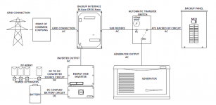

No.Maybe running the utility feed to the solar inverter through the manual transfer switch instead, ...
The problem is the photos don't show the Solaredge Backup Interface which can pass 200A through to the load. They show the older StorEdge inverter that can only pass 40A through (really only 25A, but in this case they did 40A).The diagrams definitely look off.
Here is SE's recommendation for ATS/Genset setup with the BUI:
It should be straight forward to add the ATS between the existing backup panel and the meter main panel. If only partial backup by the generator is required then nothing else needs to done.
If whole house backup by the generator is required then the non-solar backup loads need to move to a new panel since it's a meter main panel. Then another ATS (tied to the same generator) needs to be added between the meter main panel and the new panel.
Good point about the photos. I was just going by OP's diagrams that appear to show the BUI.The problem is the photos don't show the Solaredge Backup Interface which can pass 200A through to the load. They show the older StorEdge inverter that can only pass 40A through (really only 25A, but in this case they did 40A).
So if the customer wants to add any more backup loads that may not really work.
Still unclear if you are showing a separate backup panel (I see a label but not a drawing) and where the relocated circuits are tied in. But this looks better.I've made an adjustment, not sure if this is feasible but its definitely better than my original idea. this choice may actually work.
No, during normal function the energy from the solar/battery would go wherever there is load, before going out the meter to the utility. Not to worry.actually it only looks beneficial during an outage, During normal function I believe the solar would not contribute to the branch circuits with this design. unless engaged by the manual switch therefore eliminating the other 160A of utility potential.
1 back up panel which would be the 200A rated manual transfer, the original meter main will have no branch circuits connected to its distribution fins other than the initial 200A supply to the automatic transfer switch and the 40A connected to the solar inverter .Still unclear if you are showing a separate backup panel
The home owner decided to buy a 110A generac and asked if I could connect it to their main electrical which has an older solar system connected already, installed 6 years ago.But maybe that's not what you're selling, or maybe they bought the house with the solar and just don't care.
I don't see how solar would be isolated from the genset when it's feeding the meter main via the MTS.I've made an adjustment, not sure if this is feasible but its definitely better than my original idea. this choice may actually work.
The Automatic switch would tell the generator to kick in, only until the manual switch is physically engaged would the generated power supply the branch circuits affiliated within the MTS.Also, how would it isolate from the grid in the meter main?
When the grid is operating, the inverter outputs as much power as it wants (as a current source) and it goes to both connections.I guess what confuses me with the solar is there are 2 connections to/ and or from the inverter. 1 appears connected through the solar meter landing on a 40A breaker of the meter main, the other to and or from the inverter, going to the branch distribution.
Yes this works as long as the loads on the load side of the manual transfer can't possibly be connected to anything else. Your sketches showing this going back to the main panel had me worried.My idea of the Manual transfer switch after the ATS is to assure solar and generated never work in unison.
If the manual transfer is switched to the generator side, then...So if I was to disengage the solar at the branch circuit connected side of the inverter Im am thinking there would be no back feeding, although
the branch circuits would only see the inverters contribution when the manual transfer switch turns off the generated power.
It almost seems the fool proof solution is to have 2 groups of distribution for 2 different backup methods. although not too practical.
All branch circuits of the home would be attached to the MTS bussing a 200A / 60A ( if possible ) manual switch breakers will independently energize the bussings within the MTS provided distribution fin method.I don't see how solar would be isolated from the genset when it's feeding the meter main via the MTS.
Ok good.1 back up panel which would be the 200A rated manual transfer, the original meter main will have no branch circuits connected to its distribution fins other than the initial 200A supply to the automatic transfer switch and the 40A connected to the solar inverter .
I'm sure glad there are well experienced people within this forum to give me a considerate heads up on this curious installation design.In other words, it's okay.
This seems to be the customers vision, they got the generator because the solar system wasn't strong enough or would last long enough during the occasional 2-3 day outage based on high winds,If the customer wants the generator to be the primary backup, then it's more okay. Because the solar should still work okay on-grid if you don't mess with the Solaredge meter CTs. And if the customer wants to switch to the solar/battery and turn off the generator, they can manually turn off the large loads when they do that. They are just not taking advantage of the battery they have unless they do that.
