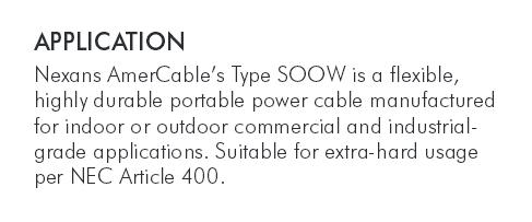

Regarding your later claim that cable vendors don't use such terminology on their sites, please see these:
https://www.tpcwire.com/products/wire-and-cable/portable-cords/super-trex-ultra-gard-portable-cords
https://www.southwire.com/products/ViperRubberTypeSOOWYellow.htm
https://www.stayonline.com/reference-cord-jackets.aspx
https://cdn.generalcable.com/getmed..._CableSelectionGuideforHazardousLocations_WEB
http://www.prioritywire.com/soow.php
http://www.dsmt.com/resources/cable-jacket-types/

All of the cable makers say "approved for extra hard usage per NEC" or "can be used for hard usage per NEC 400"
No marking on a UL cord is a designation of "hard usage" or "extra hard usage". J means 300v, no J means 600v, period.
NEC then took those constructions of spec'd cord and added words to them. 600v is just bulkier because of the higher voltage rating.
Notice it says "per NEC" and not "per UL"
