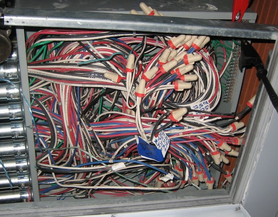

You could follow Bob's advice or end up with something like this. :roll:

If it was just normal branch circuits I would use wirenuts and not loose a minutes sleep if the finished product looked like the picture Infinity posted.
true. the sleep would be lost by the guy in two years tracing stuff out. :rant:

How about this...
How about this...
A customer of mine I'm working with has this "Picasso" in the basement next to the Service panel. It is in his long term remodel plan to clean up this and other issues.
