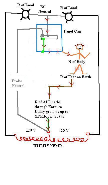

>>>>I have been reading the forums here and at the ECN website and I am learning tons already. I am certainly glad I found these websites. I have my opinions on most subjects, but if I throw out something that is wrong, you folks please please jump in and correct me! Thanks!<<<<
I thought about this subpanel open neutral versus service panel open neutral a bunch. I came up with the following drawing of circuit paths for the service panel with an open neutral. It is somewhat more complicated than just saying that we have 120 volts across a 20 ohm grounding electrode as far as I can tell.
This panel of course has a MBJ to the can and a GEC to an electrode. Again, the neutral from the utility is open. A guy is touching the panel enclosure (equipment ground) and standing on the earth (barefoot).
*Excuse the crayon mess... nothing but MSPaint at home. :)
1) Do y'all think this is representative of the paths that exist? If not, where did I go wrong?
2) If I am correct, plug in some reasonable ohm values for each part of the circuit, then do the Ohm's Law calcs and see how much voltage the fortunate man is subjected too.
*Darn it I keep finding mistakes! Assume that the two black hot wires to the loads are going through the panel and circuit breakers before they hit the loads.

Crossarm I like your drawings. :)
In this case it could be 120 volts.
He is in parallel with the other electrodes.
The question is how much current will flow through him?
Likely enough to kill.

I am hoping to develop a better understanding of how this all works. Do you agree that my two drawings are essentially correct as far as the paths current will take in the two differing circumstances?
Does anyone else have anything to say about these two situations? I see the service panel situation as being very much safer than the subpanel situation.
I am thinking that we are on the verge of making some profound discoveries about grounding here. We need to put some indepth thought into this so I (we?) can get a grasp of what is going on here and why the code rules are what they are.
Look at the things that are in series before and after the parallel parts. Is it possible to impress 120 volts on the person in the Service Panel drawing?

Re: Sub Feed Panel
Concerning the service panel with open neutral:
* I hope someone actually reads this and gives it some thought. Perhaps more myths will be dispelled? If anyone sees any problems in my thinking here, please correct me, because I am really trying hard to understand and grasp the theory of these code rules.
The way I see it, the person is in parallel with only the GEC and the electrode point of contact with the earth. And that parallel path is in series with the loads and with the resistance of the earth back to the utility xfmr. Because voltage drops divide up in series, the human will not be in contact with anywhere even close to 120 volts. Most of the voltage drop is going to occur in the earth path back to the xfmr.
The only way the guy could receive a significant shock is if the resistance of the GEC and connections was very high or if the contact resistance of the electrode to earth is very high (and these according to Soares have neglible resistance) or if it is near infinite like in the subpanel with no electrode.
Let?s look at Soares Book on Grounding to see what they say about the resistance of electrodes:
Pages 108 and 109 paraphrased:
The GEC and connections, and the electrode themselves have very little resistance : ?the overall resistance is negligible?
The National Institute of Standards and Technology has demonstrated that the resistance between the electrode and the surrounding earth is negligible if the electrode is free of paint and grease and if the earth is firmly packed.
The only component remaining is the resistance of the earth itself and this resistance will be spread through the earth along the path of conduction.
So an assumption of ?20 ohm grounding electrode? is not the electrode itself, it is the resistance of the dirt path that is being measured! And this resistance of the dirt path is also in SERIES with the human.
Let?s calculate from my drawing:
First Case
Assume only one phase wire is supplying current, all the loads on the other phase are turned off. (for simplicity of calculations)
Assume
4 ohm load resistance (120 volt, 30 amp load under normal conditions)
GEC resistance = 0 ohms
Electrode contact with earth = 1 ohm
Resistance of earth path back to xfmr = 50 ohms (pretty lousy ground really)
Resistance of body = 150,000 ohms
Resistance of feet to earth = 10 ohms
Person is using the same 50 ohm path back to xfmr
Ohm?s Law of series-parallel circuit yields less than 3 volts on the human.
Second Case
Same as above except now there are 4 ohms of connected load on one phase and 20 ohms of connected load on the other phase.
Calculating by superposition, the human gets shocked by less than 2 volts.
Much different than the case of the subpanel where the guy is receiving the full 120 volts (maybe 119 volts)

I see 111 volts on the human in case 1. You have a 50 ohm resistance in parallel with a 150,050 ohm resistance. This gives an effective resistance of 49.98 ohm for the two in parallel. The 49.98 is in series with the 4 ohm load. Using ohms law solve for the circuit current. 120/53.49 = 2.22 amps. Now solve for the voltage drop across the load. 2.22(4) = 8.88 volts dropped accosts the load. That leaves 111 volts to fry the human.
Don
Re: Sub Feed Panel
The way I am looking, the human is not in parallel with the 50 ohms. That 50 ohms exists in the dirt all the way back to the utility xfmr ground. He is in series with that 50 ohms, not in parallel with it.
I have been wrong before. If I am wrong here, please show me. :)
Is my drawing wrong? Isn't the person in series with the long dirt path of 50 ohms back to the xfmr?
[ January 04, 2005, 11:45 AM: Message edited by: crossman ]
Re: Sub Feed Panel
I think a point of confusion here is that when a grounding electrode is tested and you come up with 50 ohms, it isn't the electrode that has the 50 ohms, it is the dirt path that is actually being tested.
This pretty much comes from Soares Book on Grounding pages 108 and 109
The guy is in series with that 50 ohm dirt path.

Crossman, I like the drawings! I see the GEC resistance and the person's resistance being in parallel and those two resistances in series with the 4 ohm load. That being the case, I agree with Don, 111 V on the person. Good discussion. :)
Re: Sub Feed Panel
Okay, you guys have me thinking. I read the article and am not convinced yet.
The first thing that comes to my mind is this...
The person's bare feet standing on the ground ALSO have a 30 inch sphere of resistance and it is actually a lot higher resistance than the electrode 30" of resistance. These two 30" spheres are in parallel for the most part I think.
I presume that the 30" sphere off the feet has more resistance than the 30" sphere around the electrode because of contact area and depth.
I still see the guy in series with 50 ohms.
Question: The current that flows through the person's body... where is it going?
