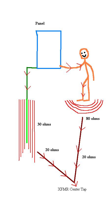

I think that you are thinking of the earth as a single path of resistance, but it reality it is multiple paths and each of these paths are in parallel with each other and that is way the human in really in parallel with the other earth paths.
Question: The current that flows through the person's body... where is it going?
The same place that all current goes...back to its source.

WOW! My mind is changing and my eyes are opening! I made another drawing and am beginning to see what is going on thanks to the help of you guys. Very cool!
What I see here is that person just MAY be in parallel with a large percentage of the electrodes resistance to ground. Before, I was assuming that the resistance of the earth was spread out evenly all along the path to the xfmr. If most of that resistance is indeed around the 30" of ground rod, then I see what yall are saying.
In this instance, he is definitely in parallel with 30 ohms of ground resistance and in for a possible nasty shock.
Obviously the possible voltage depends on the nature of the earth and the electrodes. Down here in our wet black clay soil, resistances of or 2 or 3 ohms on a ground rod are typical.
Seems that if the guy is standing right on the ground right on top of the electrode, he will be safer than if he is further removed from the electrode.
Also, the more electrodes you have and the better their continuity to earth is, the less the shock hazard. Right?

Calculation of above with a 4 ohm connected load on one phase of the panel gives a shock of 67 volts.
Now that is with the high impedance to ground.
With a low impedance of say, 2 ohms in the 30" sphere, then the shock voltage is reduced to about 9 volts.
So I am seeing that a grounding electrode has the potential to reduce the "touch voltage" if the soil and electrode characteristics are good, but if they aren't so good, then ZAP! WATCH OUT!
I really appreciate you guys bearing with me on this and I definitely have a better understanding of the whole thing now. Awesome. :) :) :)

Crossarm I really do like the drawings they add some fun along with some clarity to the subject.
These forums have taught me more than all the classes I have attended. It is a great place where we all learn.
I would like to add something about your latest drawing you posted at posted 01-04-2005 12:44.
It is true the power is heading back to the center tap of the source transformer however due to the utilitys use of a single MGN for everything and the bonding at each house the current path through the earth is likely to be in all directions.
