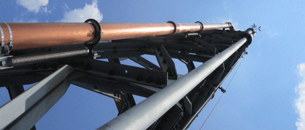

Us hams call it Hardline
Curiously enough, they call it "Flex" and also offer a line of rigid transmission line. It bolts together like high-pressure flanged steam pipe.
They also have rectangular waveguide which has no center conductor as coaxial waveguide or cable does. It will only propagate signals above a certain "cutoff" frequency, whereas coaxial (i.e., TEM mode) will propagate all the way down to DC.
Optical fiber is a circular dielectric waveguide which also has an associated cutoff frequency below which electromagnetic waves will not propagate.
