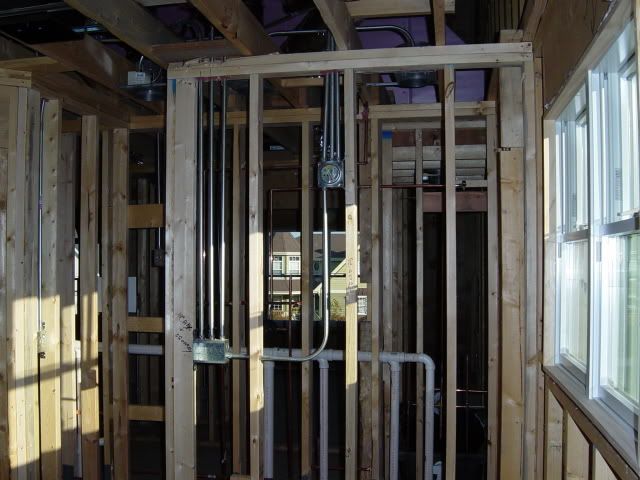

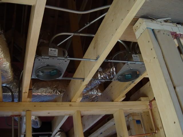

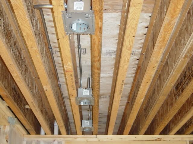

There are some pictures somewhere on this forum of a Chicago EMT job, I will look for them.
iwire
Massachusetts
Well I found where the pictures where but the server they are own is now gone.
I do not recall any notching, a lot of vertical EMTs and a lot of couplings.
They also do not bother to closely follow the lumber like we would when the work would be exposed.

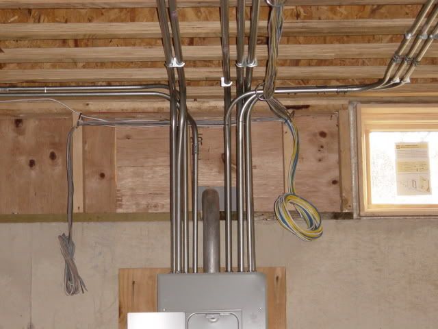

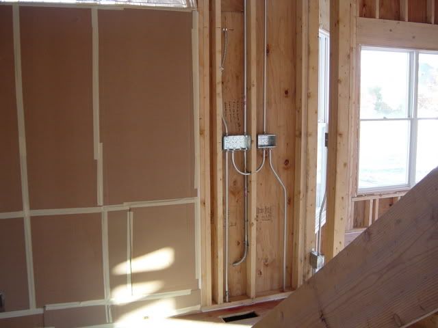

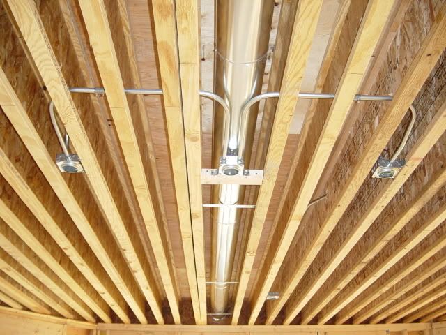

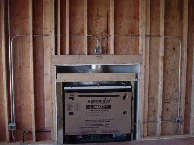

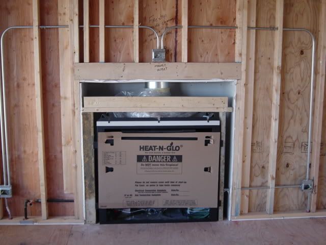

I know Scott hasn't posted in a while, but my hat is off to some nice work. As is mentioned in the thread by some of the responders, there is definitely a lack of securing and support for the raceway -- at least at the time the photos were taken.
While making offsets is not a problem per se, offsetting to studs will add to installation time and I probably will run out of room in a lot of locations, e.g. large switch boxes. Also, I suppose that -- as some one else said -- I will be using a lot of couplings. Normally a lack of such is a mark of pride since it means that everything was laid out perfectly, but in this case I think it will just add to the work I have by me trying to figure out out to snake long distances of bent steel tubing into studs.
By the way, I like the concept of spidering out from the ceiling, though I am never crazy about lots of holes in joists (as opposed to studs). Probably (at least for receptacles), I will have one branch for each wall coming from the ceiling, and the rest running horizontally (at 24" AFF) to supply each receptacle.

The pics in two posts

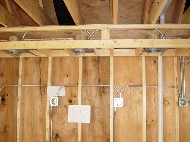

iwire said:
It is great looking work, even with the NEC violations. :grin: (lack of supports)
I wonder if Chicago requires an EGC to be pulled in or if they can use the EMT. If they allow the EMT as equipment ground, proper strapping is vital. For instance, in some of those vertical runs, they are sure to get banged around during construction, and this could definitely cause the locknut in the box to loosen. Strapping EMT is not solely for support. It is to help insure and maintain proper grounding too.
I know that some Chicago guys have said they do not pull EGCs.
I agree to some extent but I really do not see any conduits in those pictures that I would expect to be loose. If they tighted the fittings well a little bit of banging around during constrution is not (IMO) going to loosen anything up.

Maybe, maybe not. In your post #11, in the last pic, if the vertical run with the offset were pushed back at the top of the offset, it could loosen the locknut. Of course, the locknut could be retightened fron inside the box, but would it be?
I think my statement stands that EMT strapping serves two purposes. One for support, the other to help maintain continuity by preventing the EMT system from wiggling arouns and transmitting this movement to fittings, thereby loosening them.
