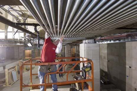

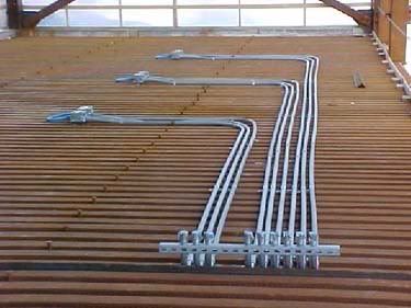

iwire said:
It is great looking work, even with the NEC violations. :grin: (lack of supports)
Yeah looked like they ran out of hanger bars.
