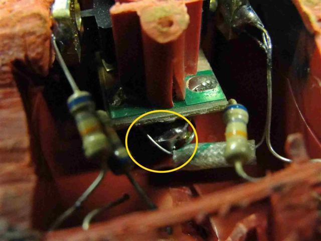

And BTW, I have personally had 3 of the same neon testers you modified fail violently in normal use. (2 major burnouts and one where the tester smoked and stopped working.)
Funny, I just had that happen to me today for the first time with my standard tester. The outlet had a lot of paint on it, and as I pushed my tester in to the outlet, there was a big flash and the circuit breaker tripped.
I cut my tester open to figure out what happened; the ground pin pushed itself back far enough to come in contact with one of the wires.
What a coincidence.
What a coincidence.
Welcome to the forum, Rueben. Good to have you. Anyone who read all the post knows I am the one that used the term "the guys an idiot". I want to offer my apology to you because as noted, that was unjustified.
ps: this picture is the type of failure we were concerned about. Or either failure of solid state circuitry.Both dangerous on your tool
