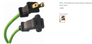

Also, what's the difference between the below vs a hypothetical 10/2+16/1 as far as instantaneous trip?
