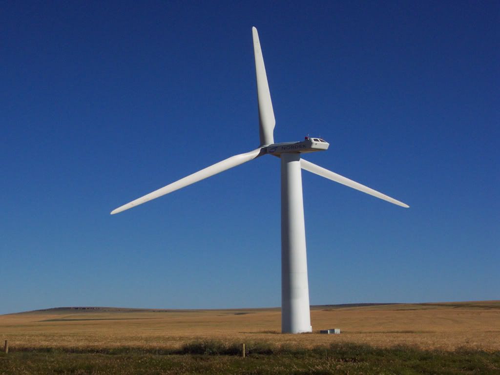

The wind farm I am doing some work with, generates DC. At the bottom of the tower is an PWM inverter to 770VAC three phase and a setup transformer to 34.5KV. Several transformers are paralleled on each a circuit The 34.5kV circuits are then run to a collector yard where the voltage is stepped up to 138KV.

I drove past a large farm in Canada on vacation and got close enough to one to take a picture that showed how big the carriage was and you can see the transformer on the ground.

Electical contractor Magazine just did an artical on a wind powered gen site,and they described installation details of the 260 ft. towers pulling cables inside the towers straight down from the 1.5 mw. nacells.

Most of our turbines are 2.1 MW machines and they are ~280' to the top. The model that we primarily use has a ladder in the tower... making for a very fun climb to the top. There are platforms for each of the tower sections that you can rest on. It is great to climb out on top of the nacelle!
