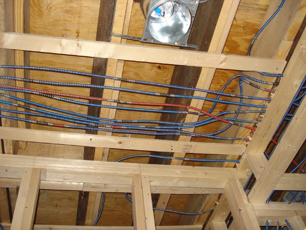

This creates a 3/4? channel below the ceiling joists that some electricians use as a chase during the rough to run their wires and avoid the time necessary for drilling. I personally do not like this method as I feel it is not safe.
I was perusing some photos of a sweet home office when I saw the rough-in phase. This was the first thread that I found that seemed relevant to post about it.
Here's the site: http://www.biscade.com/office/ It's the 3rd picture from the bottom. I don't even know if it could be classified wall or ceiling.

Pictorial example of cables between strapping.
Peter,
That is a good photo, very clear.
That 'looks' like a violation,
but if the AHJ approves it, I could live with it.
I'd be the first to say I've certainly seen really dangerous ones.
