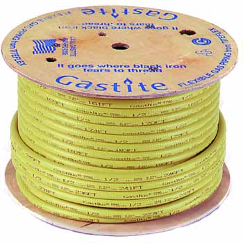

Dennis Alwon said:
It looks like this
Thanks Dennis for the picture, now I know what it looks like, and thanks to iwire & wbalsam1 for explaining what it's used for.
This is why the forum is so great ... you can check it out and be guaranteed to learn at least 1 new thing each and every visit .
In case others had missed the relative posting ...
" CSST : Corrugated Stainless Steel Tubing = The yellow covered gas tubing so prevalent in dwellings today." Quoted by wbalsam1
I hope you don't mind my quoting you wbalsam1 ?
Carl :)

Pierre: The picture showing the bonding conductor...isn't this conductor required to be a #6 as per the manufacturer's installation instructions? :confused: :smile:

wbalsam1 said:
Quote me all you want, Carl. :smile:
Yeah, that bond wire looks awfully small...
I believe I remember seeing a table in the manufacturer's installation instructions that came out after the class action lawsuit that sized the bonding conductor according to the size of the service amperage, and I think this conductor looks too small. :smile:

I do not know what size the bonding conductor is. I was in the building inspecting for low voltage, a different inspection company was inspecting the power. That's right, ECs can use different inspection companies.
There are six different manufacturers of CSST and I believe that they basically have six different installation instructions.
How do you like the rust on the gas pipe? Makes for a good conductor :rolleyes:

Pierre,
Is the short precut section really CSST, or is that an flexible gas appliance connection? It is my understanding that you can't use CSST in place of a flexible gas appliance connection as it is not as heavy walled as the appliance connection.

don_resqcapt19 said:
Pierre,
Don
Mine too, you cannot use CSST as a flexible gas connection.

One more thing Carl. The yellow cover on it is made just like the gray cover on Sealtight. Except for the fact that it is stainless steel and corrugated, you would almost think that it WAS Sealtight.
