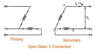

So I understand that one only needs two hots and a neuter for an open delta, but I dont see the logic in a POCO running two phases and neuter. Why not just run three phases? I guess if they want to make it a MGN is that it?
jumper
I am guessing that the premise is that POCO has 1 phase and a neutral feeding a tranny existing.
Add one phase conductor and one tranny and you have an open delta 3 phase.
I am a bit fuzzy on how exactly this works, but I only work off the secondary side so I ain’t gonna worry too much.

Stumbled across Seattle City Light's construction document for open deltas.
http://www.seattle.gov/light/engstd/docs2/0125.02.pdf
It appears they feed them with two hots and neutral, even if they have all 4 wires. They have some good jargon too: "Teaser" and "Lighter" for the transformers :)
You are looking at the secondary connections. That document is a little unclear because they show two primary connections, not the third, then they discuss the neutral in context with the secondary. SCL is one of the few places that will derive a 240/120 3 phase 4 wire service from an open delta bank. I had one at my shop in Seattle, it confused people a lot, even me, because it’s somewhat rare. But there STILL must be 3 primary phases. The open delta just saves them the cost of one transformer.
As to 240/120 3 phase 4 wire services in general, utilities that still offer it will often limit the 120V loading to 5% of the total load, because it is inherently unbalanced. The intent of that service is for customers with MOSTLY 3 phase loads who need a SMALL amount of 120V lights and receptacles, NOT the other way around. If most of the loads are single phase with a few 3 phase, they will want you to accept 208Y120 and balance the loads. MOST 230V motors 5 HP and under are designed to allow for 208V input, but if not, use buck-boost transformers for them.

Okay, I got some people saying that the open delta is fed with two phases and a noodle.
Another just said it is three phases.
Anyone know exactly which is correct?
We all agree that it is only two trannies.
mivey
Open delta to delta requires three phases.
Open wye to delta requires two phases and a neutral.
