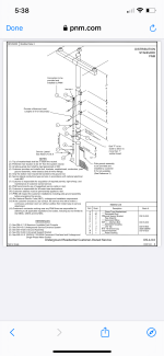

The original state inspector told me that they have jurisdiction up to the weather head. It’s a proper pole that’s about 35’ tall with a transformer mounted on top.

If that’s the case then the wire I ran would fall under the New Mexico code and not NEC article 310.3(b)

No, per the quoted text, the customer still "owns" and "maintains" the conductors, which means they are not under "exclusive" control of the utility. At most it is joint control, the customer has to get POCO permission to make changes, but the customer has to make the changes themselves.
If the customer had to design and install the conductors, and then the utility assumed ownership and maintenance of them, and had the right to make changes without the customer's permission, that would be "exclusive" control of the utility.
Of course, this back and forth is only relevant to the OP if their POCO is PNM (sounds like it is), and if they are installing conductors under those provisions of PNM's Service Guide.
Cheers, Wayne
Not following you. If several years after you install the wire, a fault develops, who's responsible for fixing it? The POCO or the customer?
